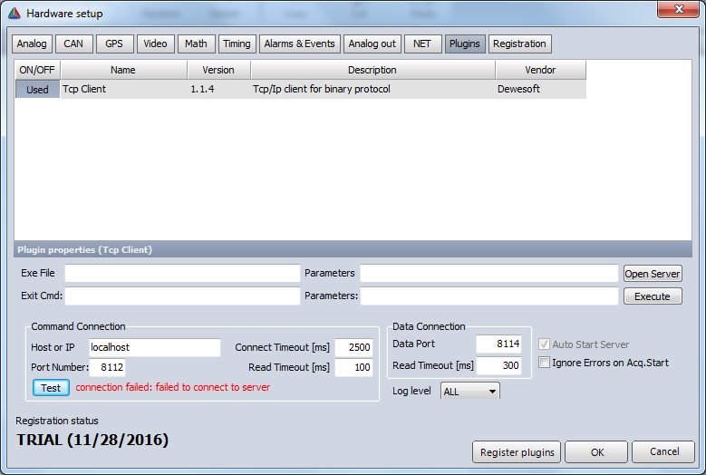

I had made a server for that plugin but it's not working in Hardware setup of Dewesoft.
After pressing the test button, in log file everything looks fine.
03.11.2016 20:47:30:713 [DEBUG] starting TCP connection: localhost:8112
03.11.2016 20:47:30:713 [TRACE] calling FIdTcpClient.Connect
03.11.2016 20:47:30:838 [ INFO] started TCP connection: localhost:8112
03.11.2016 20:47:30:838 [TRACE] Command: getProtocolVersion
03.11.2016 20:47:30:838 [TRACE] Response: 1
03.11.2016 20:47:30:839 [TRACE] Command: disconnect
03.11.2016 20:47:30:839 [TRACE] Response:
03.11.2016 20:47:30:839 [ INFO] disconnected TCP
But the message always shows "connection falied : failed to connect to the server".
Please refer to the attached screenshot.
Did I miss any command to reply the test request?
Thanks!

Posted on 04.11.2016 03:38
update the log file
03.11.2016 21:37:54:739 [DEBUG] starting TCP connection: localhost:8112
03.11.2016 21:37:54:739 [TRACE] calling FIdTcpClient.Connect
03.11.2016 21:37:54:864 [ INFO] started TCP connection: localhost:8112
03.11.2016 21:37:54:864 [TRACE] Command: getProtocolVersion
03.11.2016 21:37:54:864 [TRACE] Response: 1.1.4
03.11.2016 21:37:54:865 [TRACE] Command: disconnect
03.11.2016 21:37:54:865 [TRACE] Response:
03.11.2016 21:37:54:865 [ INFO] disconnected TCP
Martin Trummer
Software Development
Posted on 09.11.2016 10:18
hi,
when you press the Test button in hardware setup, then the plugin will open a TCP/IP connection. Your server must respond with the welcome message immediately Example:
+CONNECTED to: YourAppName
then the plugin will ask for the protocol version that your server supports - the response must be exactly
+OK 1.0
BR
Vincent Yang
Posted on 09.11.2016 11:09
Hi Martin
I change the protocol version to 1.0 and 2.12, but the result is still the same.
Please take a look at the attached captured packet by microsoft network monitor 3.4.
Thanks!
Martin Trummer
Posted on 10.11.2016 13:41
we will clarify the issue directly via e-mail.
