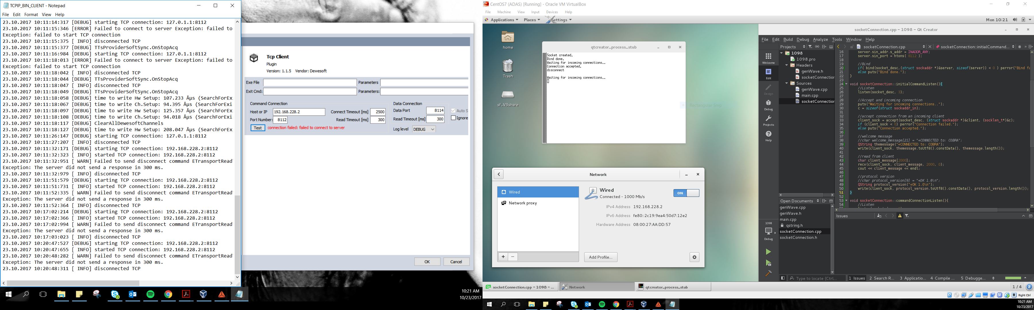

- In the screenshot "timeout.txt" I attempt to connect to my server using the DeweSoft TCP/IP client plugin. My accepts the connection and sends the welcome message. However, it reads "disconnect" and the returned message instead of "getProtocolVersion". The log says there's a timeout issue. I have tried timeout values of up to 5000ms, and still the same error.

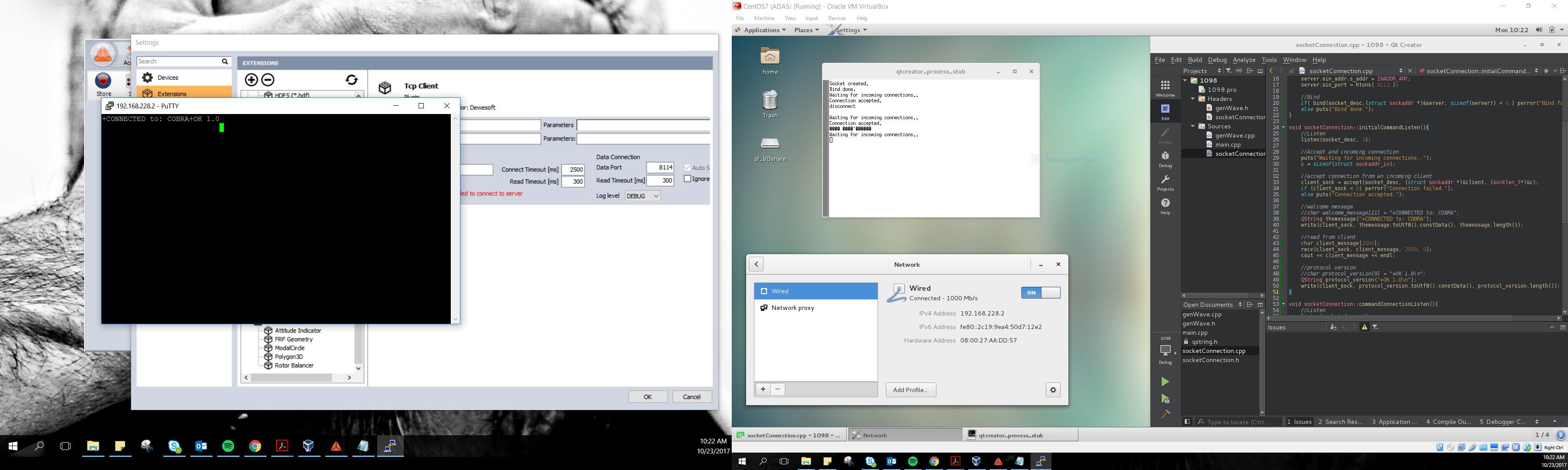

- In the screenshot "putty.jpg" I use telnet to connect to my server. PuTTY displays displays the welcome message and protocol version. So I know the correct data is being sent both ways.

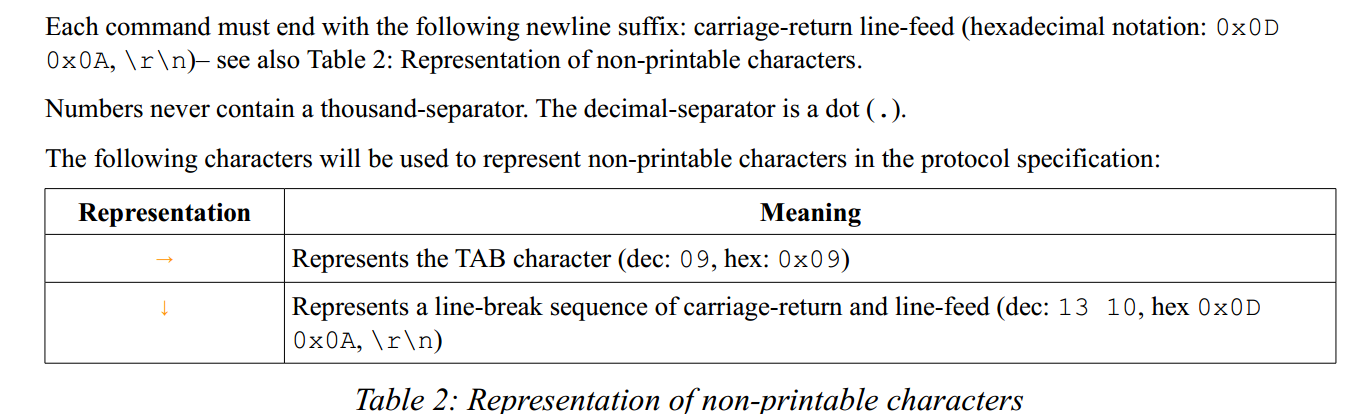

is it possible that you're not sending the correct newline suffix? I've attached an image from the manual which refers to this section.

Wow. That was it. I thought it was "/r" or "/n", but it's "/r/n". Geez. Thank you.
