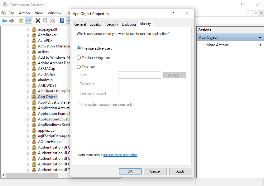

please make sure to correctly configure DCOM on the remote computer. You can do this with the application "dcomcnfg", by choosing the "interactive user" option, which is selected in the attached picture.
If that won't help, I'm going to need some more information.
Thanks! Finally I'm able to interact.
