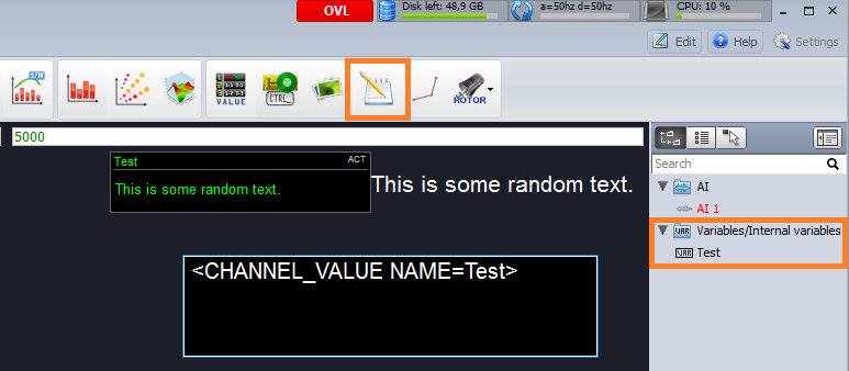

I use the sequencer to set the value of a Text global variable.
I would like to display that text variable on the Measure screen, but it doesn't seem possible.
Let me know how to do this, if there is a way
Thanks
DEWESoft Support
Posted on 09.05.2017 09:09
you can display text data on the measurement screen. The first visual control that allows you to display text is the digital meter, while the second one is the note. In the note you can incorporate values of variables in combination with custom text. I've attached a screenshot that shows both options and also the configuration of the note visual control.
Let me know if you're able able to able to use this functionality or if you're still having problems. One thing to differentiate here is that sequencer variables aren't the same as global variables. The former are only used within the sequence, while the latter can be used in both, the sequencer and in the setup.
