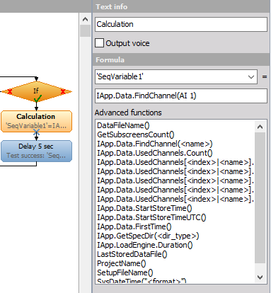

In other news, our development team has added an ability for you to check if a channel exists. This is done through the calculation block by calling the function in the attached picture. As an example, calling IApp.Data.FindChannel(AI 1) will return a 1 or a 0, depending if that channel exists. You can also use a variable for the channel name, you just have to add '' marks around it.
The version that has this update (X3 SP3) has just become available online. I'll also put in a request for another feature, which would return 1 or 0, depending if the system is in acquistion mode.

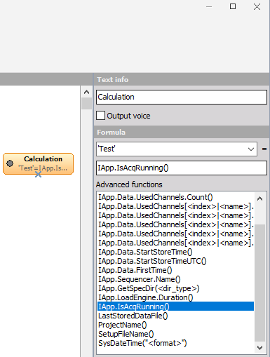

I would like to notify you that another one of the features that we've discussed in this thread had become available online. In the latest DEWESoft X3 SP3 DEV-180302, you can now check if DEWESoft is in acquisition or not using the sequencer. This is done with the calculation block using the "isAcqRunning" function. I've attached an image of the function.
