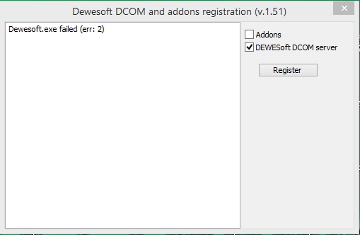

getting an error with the following info once trying to register DCOM ;
Dewesoft DCOM Server (Clicked)- Register --> dewesoft.exe failed (err:2) on Windows 8.1

we've seen a similar issue in the past. Please try running DEWESoft as administrator (right click on the icon and choose the run as Admin option). After that, run the DCOM registration file and register DCOM. Even though you will see the same message, the DCOM server should now be registered.
Please try the above solution and let me know how it works out for you. If you're still unable to use DCOM, then I'm going to need some more information to troubleshoot the issue like DEWESoft version etc.

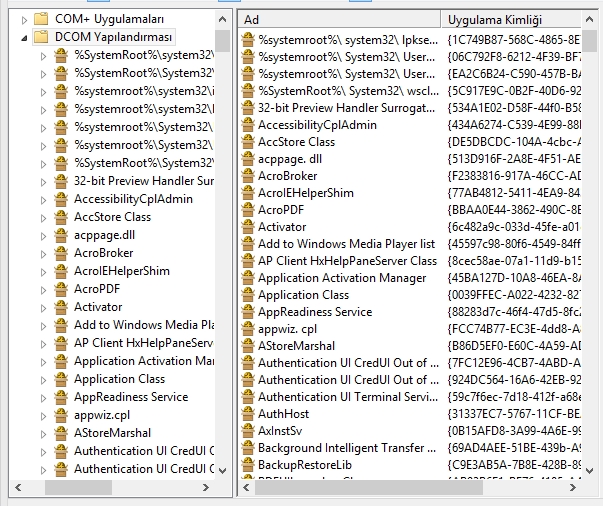

I am following the DCOM manual. Unfortunately App Object is not visible. Please check the atteched picture.
My system is 64-bit.
Thanks
Mert
just to confirm, did you make sure to launch the component services from the command prompt using this command: mmc comexp.msc /32?
If you did not, you won't be able to see the App object on a 64-bit OS.
