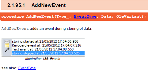

We would use load setup, StartStoring to specified file, and it would be good if the function AddNewEvent worked (it does not seem to).
We'd like to add test events during recording.

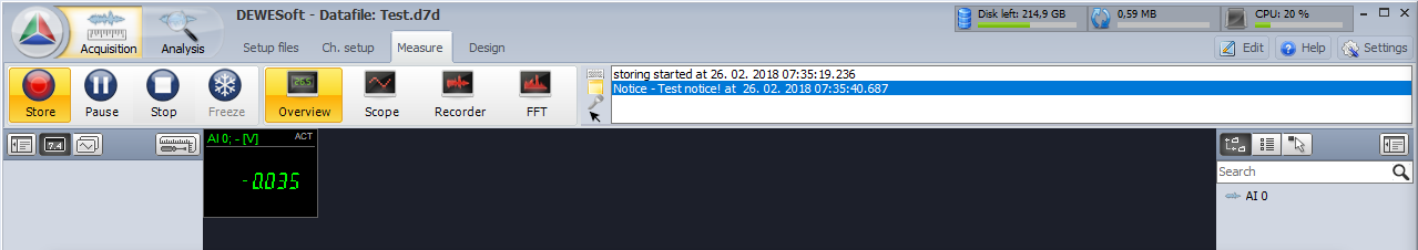

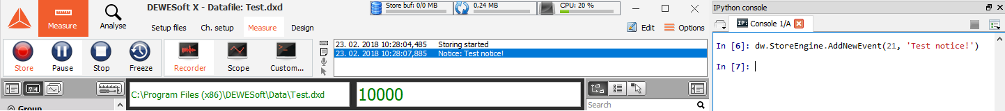

As for your second request, I'm able to add an event without problems. Please take a look at the attached image. If you still have issues, please share some details regarding the events you're using.
I would guess you see this working due to the version of SW running on the DEWETRON instrument.
We have many instruments at version 7.0.2. The one I've been testing has version 7.1.1. On 7.1.1 I also get error in expected for the load setup command but not the store to file command. Add event indicates something like 'not a know cmd' or something similar.
I was not aware that you are using DEWESoft V7. That changes things a bit. As an almost obsolete program, DEWESoft V7 only receives urgent bug fixes, while its development is continued in the X3 branch. If the development team decides to implement the error return features that I've added to our system, then please be aware that those will only be added to the latest version of X3, as that is the development branch.
Back to the events, I've switched to the latest DEWESoft V7.1.3, and I'm still able to add the notice event (attached image). Please try to update your DEWESoft to this version, and see if that will allow you to correctly add the same event. If it still won't work, then I think it's fair to say that the issue is somewhere on your end.
