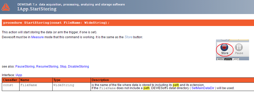

I want to execute a measure with Dewesoft out of a Matlab script. For this I start Dewesoft out of the script and load a sequence, this works fine. Is there a possibility to define with Matlab the path where Dewesoft should save the file? (Cycled measure and each file should be saved in the related folder created by Matlab)

if you look in the developers section, you should be able to find the start storing procedure (attached image), which lets you define the name as well as the file path. If the path is not included in the name, the default storing directory will be used, which can also be changed.
Using the latest MATLAB automation example and calling something like "h.StartStoring('C:\Users\Brian\Desktop\Test.dxd');" should do the trick.

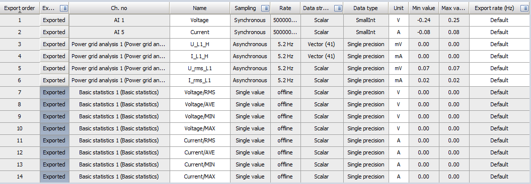

After storing, I open the .dxd file in Analyse mode and compute some Offline math. This is managed via MATLAB. After the calculation I wish to export only some of the calculated channels. Is it possible to define with MATLAB the channels that have to be exported (Only offline calculated channels and not the others)?
