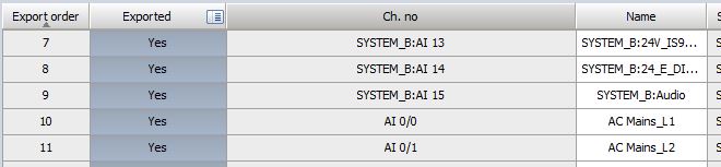

When exporting via DeweSoft, there is another column for each channel called "Ch. no" which is prepended to the exported name, making it unique.
E.g. "AI 0/0 / AC Mains_L1"

Thanks for the reply. It looks like it will be possible to parse this from the setup xml file.
