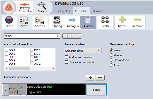

the module that will give you the most control via DCOM is alarms. Alarms can be set in the same way as storing triggers, and you can create them through DCOM. Even though they can be set for specific channels, they're not really a "channel property". You can access them via the IAlarms and IAlarmCond interfaces. There aren't any examples that I'm aware of, but you can post follow up questions here if you get stuck at some point.

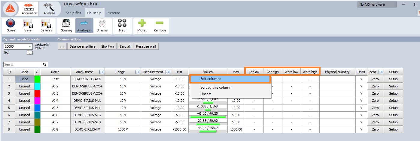

If you want to define the high/low values for each channel, you can do that via the channel setup grid, which gives you the option to add critical/warning values for each channel. This however can not be accessed and configured via DCOM. The attached picture shows the new columns, which you can add by right clicking on the top of the grid and selecting the "Edit grid" option.
