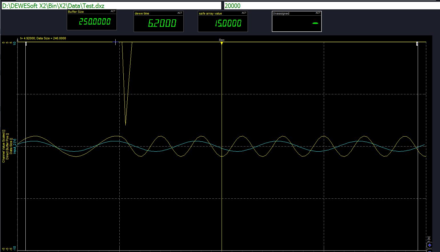

However now I am seeing an issue where my data changes after the buffer fills and wraps. I will need to trouble shoot this now, any suggestions are welcome.
I was just about to write back about the mounting issue, but it seems you have that all figured out. Could you perhaps explain what your new issue is in a bit more detail?
Since you're talking about buffers wrapping around, I'm guessing that you're having trouble with reading data. Is that correct? If so, these two general guidelines could be useful in your development:
