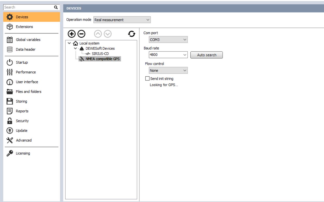

I am trying to use a Garmin GPS18x USB device with my Sirius system but I am having no luck getting Dewesoft to recognize it. The computer is running Windows 10. I can see the GPS device in Windows. Dewesoft, however, can't find the device. In the Dewesoft setup screen it only gives an option for looking at the COM 3 port. On my computer system COM 3 is taken by another device. Is there a way to have Dewesoft look at other ports, or do I need a different GPS device?

unfortunately this version of the Garmin GPS will not work in DEWESoft, because it's only able to output data in a Garmin proprietary format.
If we look at this page on the Garmin website, they note the following information:
"GPS 18x PC — has DB-9 pin serial connector with a 12 V cigarette lighter adapter; can output data in NMEA 0183 format (industry standard) or proprietary Garmin format.
GPS 18x USB — has A-style USB connector, compatible with USB 2.0 and 1.1 full-speed hosts; can output data in Garmin proprietary format only.
GPS 18x LVC — has bare wire for connection to a variety of applications; can output data in NMEA 0183 format (industry standard) or proprietary Garmin format; provides a pulse-per-second logic-level output with a rising edge aligned to within 1 microsecond of UTC time".
If you want to use a 3rd party GPS in DEWESoft it has to support the NMEA 0183 format (which is a standard GPS format). The list above shows that the Garmin GPS 18x PC and 18x LVC are able to output data in that format, but the USB version is not.
