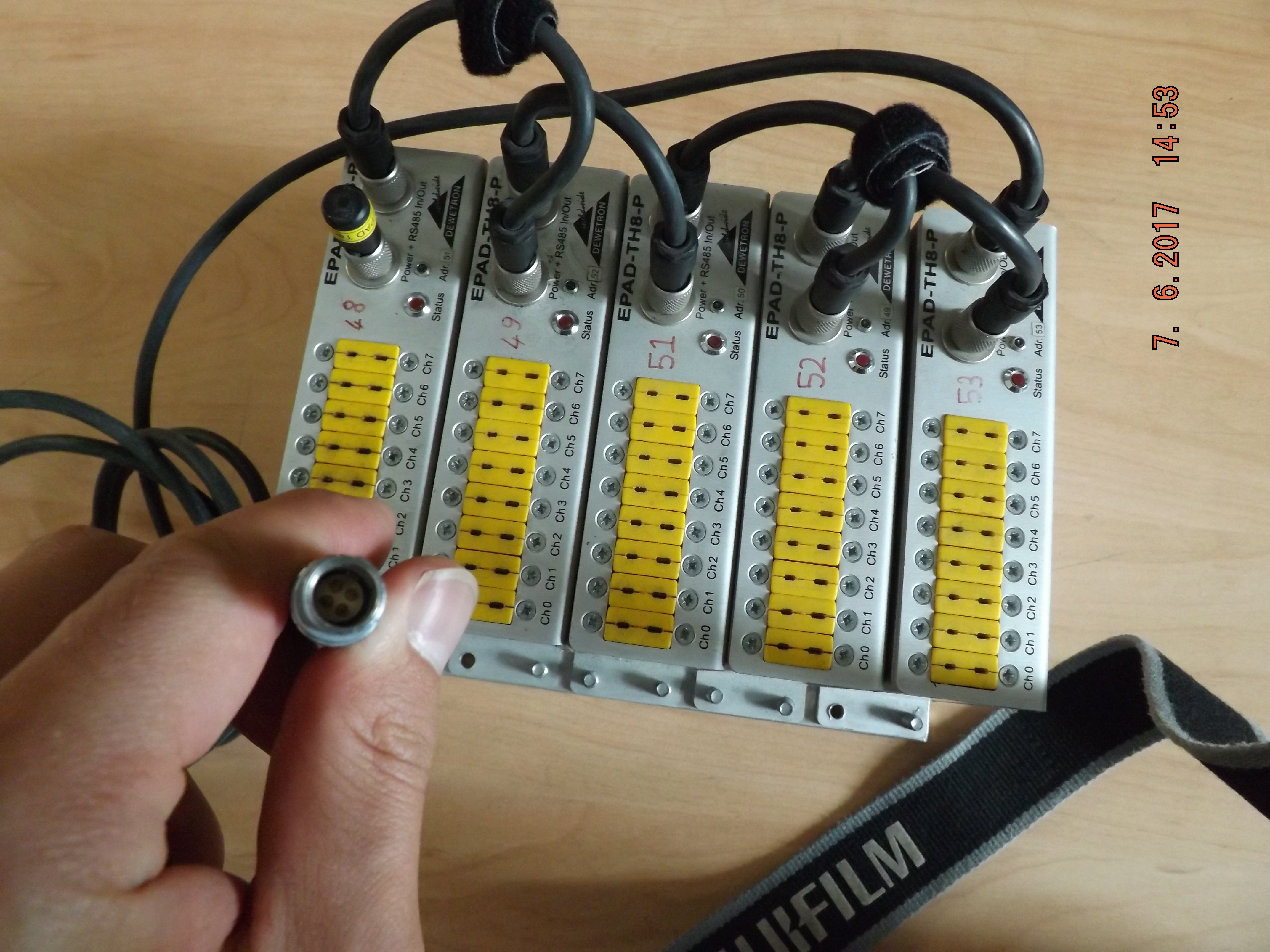

Hello
We are using epad th8p thermocouple units with Dewetron 501 data logger.
Can we use this modules with Dewesoft Ds-Net ?
Thanks
DEWESoft Support
Posted on 05.09.2017 08:28
first off, I apologize for the long delay between your question and our response. Unfortunately there is no way of connecting these DEWETRON modules to a DS-NET, as they are communicating over the RS485 interface.
There are however some newer EPAD versions with a 4 pin Lemo connector, which can be reconfigured as a CPAD units, and can than be used as a CAN output instead of RS485.
Hasan Elbaşı
Posted on 21.09.2017 15:20
Can we use Epad base2 module for conversion of RS485 to can or usb ?
