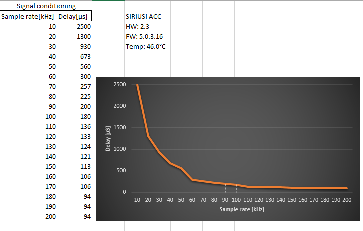

How much delay is there between analog input and analog output in signal conditioning mode?
DEWESoft Support
Posted on 15.07.2015 09:46
the delay is dependent on the sample rate of the acquisition.
We have made a test with multiple sample rates and here are the results:

Hi, the picture is attached
