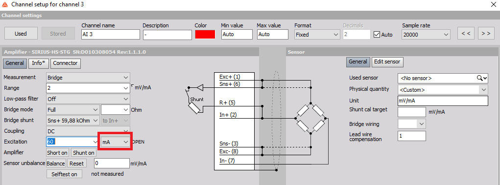

How to select Current excitation on STG slices for Bridge mode?
Ronald Swecker
Posted on 06.02.2018 17:53
I have seen this done on the SIRIUS hardware, but it is not selectable on my STG slices. Is this just a Firmware update or is this type of excitation only available on specific STG slices?

You can change to current excitation by selecting the units to mA in channel setup menu (as seen on the picture). Do you have that option?

No, I do not have an option only “V” is avail
