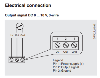

to connect the sensor to MinitaurS we recommend the voltage option.
Here is the connection that needs to be used:
Uv Pin 1 -> Exc+, Sns+
Out Pin 2 ->In+
Gnd Pin 3 ->In-, Exc-, Sns-
If a long cable will be used, it is recommended to connect IN- and GND near the sensor to avoid measuring the voltage drop.
